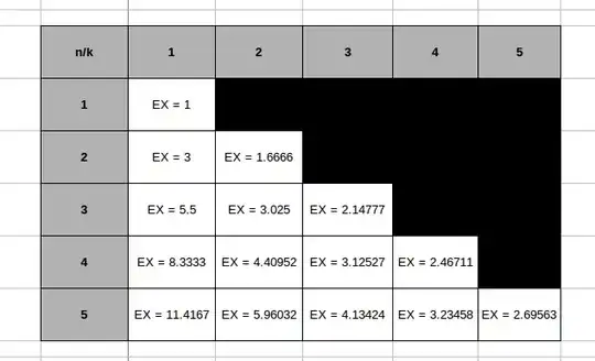

If it helps, I've also made some simulations and estimations, and came up with this table: https://i.sstatic.net/QsKnJ.jpg

  • Note that the formula derived in my answer to the duplicated question reproduces the numbers in your table. – joriki Jun 18 '16 at 00:11
