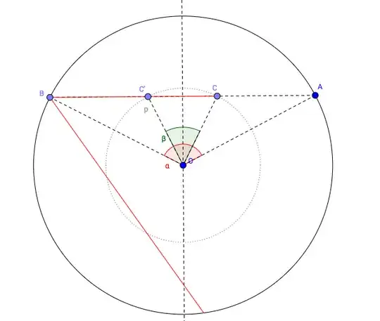

This can be solved completely by characterizing the set of points on the ray which are the same distance from the center as the original point. We consider two symmetries which generate all such points. Here is a diagram showing all the points we consider:
In particular, if our initial point is $C$, consider the line $AB$ which is coincident with the ray and which has $A$ and $B$ both on the unit circle and $B$ in the forwards direction of the ray. This segment would be visible if you shot a ray in either direction, and it did not bounce. Notice that, if $O$ is the center of the circle, then the angle $\alpha=\angle AOB$ is significant since rotating by $\alpha$ (in the same direction as the rotation that takes $B$ to $A$) takes one segment of the ray to the next segment after it bounces.
One may notice that this rotation preserves the distance from the center of the circle - so every point ever at this distance in any segment of the light's path is such a rotation of one at that distance on $AB$. There may be at most two such points - the point $C$ itself, and the point $C'$ which is the reflection of $C$ through the perpendicular bisector of $AB$. Let us set $\beta=\angle COC'$ which should be taken as a signed angle - so if the rotation taking $C$ to $C'$ is the opposite direction as the one taking $A$ to $B$, we take $\beta$ to be negative. We will always consider $\alpha$ to be positive.
Notice that if the ray returns, then there is some non-trivial rotation taking $C$ to itself. That means that one of the following is true (for some integers $n,k$): $$n\alpha = 2\pi k$$ $$n\alpha + \beta = 2\pi k.$$ This completely characterizes the problem. One should note that any point inside a circle along with a ray extending from it may be described up to rotation and reflection by a pair $(\alpha,\beta)$ with $0\leq \alpha \leq \pi$ and $|\beta|\leq \alpha$.
The case of $C$ being on the circumference corresponds to the case $|\beta|=\alpha$. One should note that the first set of solutions is just when $\alpha$ is a rational multiple of $\pi$, in which case the ray is truly periodic. Moreover, if $\beta$ is a rational multiple of $\pi$, then the second set of solutions doesn't add any new solutions for $\alpha$ (meaning that if the ray ever returned, it would be bouncing periodically).
Milo Brandt
  • 61,938
  • Nice approach. Since chosen $C$ and $\alpha$ is not obvious what will be $\beta$, do you think it is possible that for some $C$ there exist only one angle $\alpha\neq k\pi$ for which the ray will return? – mrprottolo Jan 05 '16 at 10:03
  • @mrprottolo I'm not sure. A related statement is that, except for at the center or on the circumference, there exist infinitely many solutions of the form $n\alpha + \beta = 2\pi k$. However, we could still get unlucky if all the $\beta$ happen to be rational multiples of $\pi$ (which is more or less what happens on the circumference). It's worthy of note that to fix a point $C$, we just fix the quantity $\frac{\cos(\alpha/2)}{\cos(\beta/2)}$ which is the distance of $C$ from the center. – Milo Brandt Jan 05 '16 at 16:56
  • So the problem reduces to: given$0<d\le1$, to find $\alpha$ such that $$n\alpha +2\arccos(\frac{\cos (\alpha /2)}{d})=2k\pi$$ for some $n,k \in \Bbb Z$. This looks hard. – mrprottolo Jan 05 '16 at 17:03
  • @mrprottolo You want $n\alpha + 2\arccos(d\cos(\alpha/2))=2k\pi$. You could also simplifying (by taking $\alpha$ and $\beta$ to be the half-angles) to finding solutions to $n\alpha + \arccos(d\cos(\alpha)) = k\pi$. I agree that that looks hard. – Milo Brandt Jan 05 '16 at 17:10

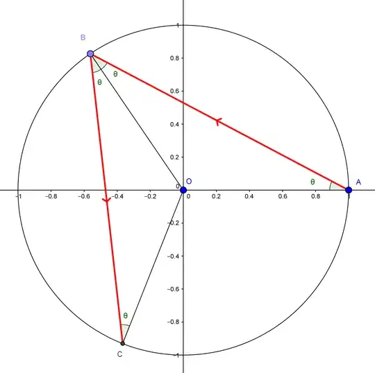

Once the ray of light hits the wall for the first time, it will bounce off at a certain angle. Since all points on a circle are essentially the same, the question is: if a ray departs from a point $A$ on a circle at an angle $\theta$ (from the radius at that point), where will it go?
Look at the following diagram.
The equality of the angles $OAB$ and $OBA$ is justified since $AOB$ is an isosceles triangle. The equality of $ABO$ and $OBC$ is justified by the law of reflection, combined with the fact that the radius $OB$ is normal to the circle at $B$. These arguments can be continued to show that every time the ray hits the mirror, it will do so at an angle of incidence $\theta$!
Now, the points $A$, $B$, $C$ at which the light hits the mirror are the first in a sequence $A = x_0, x_1, ...$ of points. What are the polar coordinates of these points? The angular coordinate of $A = x_0$ is of course $0$. And $B=x_1$? Looking at the diagram, we can see it's $\pi - 2\theta$. In fact, it should be clear that the angular coordinate of $x_n$ is $n(\pi - 2\theta)$.
Thus, we can forget about the ray of light and laws of refraction. We are simply interested in a sequence of angles $n\alpha$ for some angle $\alpha$. Is it periodic, for instance? Since $n\alpha$ is the argument of $(e^{i\alpha})^n$, we can also view this as a question about complex numbers, a question which is well known and solved. In short, the answer is: if $\alpha/\pi$ is rational, the sequence is finite (and thus periodic). Otherwise, the sequence is dense in the circle, that is, your ray of light eventually hits more or less every point in the circle.
The questions about which points inside the circle the light crosses as it does this (does it return to its original position, etc) can probably be deduced from the above facts. Certainly the light will never return to its original position with the same velocity vector unless $\alpha/\pi$ is rational (in which case it will), since this is equivalent to the sequence $n\alpha$ being periodic.
If $\alpha/\pi$ is not rational, the set of points on the circle struck by the ray is dense in the circle, thus I imagine the set of points the light passes through is probably dense in the disk, though I suppose it might not be. If so, we can at least say the light will pass arbitrarily close to its starting point.
