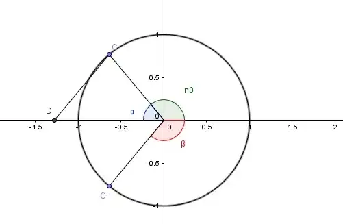

Using geometry of complex: enter image description here
By construction, point $C$ corresponds to $z^n$ an $C^\prime$ to $z^{-n}$. i.e. $\beta=-n\theta$ (the symmetry of the image is due to the fact that $|z|=1$, and thus $z\overline{z}=1$). Then $z^n+z^{-n}$ is, interpreting as a sum of vectors, the vector $\vec{OD}$. Then, by means of Cosine Law's, it is easy to conclude.
