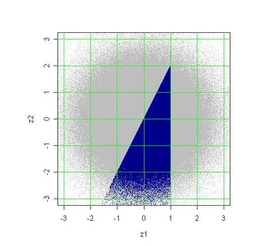

For an uncorrelated bivariate normal distribution, simulation is especially easy. Here is an approximation based on a million simulated points with $x = 1$ and $k = 2$. The answer should be correct to 2 or 3 decimal places.
 m = 10^6;  x = 1;  k = 2
 z1 = rnorm(m);  z2 = rnorm(m)
 mean(z1 < x & z2 < 2*z1)
 ## 0.342797
The dark points in the plot below satisfy the desired condition.
