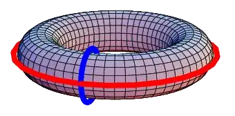

Another place where bilinear and quadratic forms appear naturally and have geometric meaning is in algebraic and differential topology. If $M$ is a compact connected oriented $2n$ dimensional manifold, the wedge product induces a bilinear form on the vector space $H_{\mathrm{dR}}^n(M)$ of $n$-dimensional de Rham cohomology classes on $M$. Using Poincaré duality, one can interpret this bilinear form as computing generic signed intersections between $n$ dimensional submanifolds of $M$.
I can demonstrate this intuitively for the case $M$ is a two-dimensional torus. Consider the following image (taken from the Wolfram Mathworld page on homology intersection):
For the torus, $H_{\mathrm{dr}}^1(M)$ is a two dimensional real vector space and we can choose a basis $\mathcal{B} = (v_1, v_2)$ for $H_{\mathrm{dr}}^1(M)$ under which $v_1$ corresponds to the blue circle in the picture and $v_2$ corresponds to the red circle. On $H_{\mathrm{dr}}^1(M)$ we have a bilinear form $g$ which encodes the intersections between the circles. We have $ g(v_1, v_1) = 0 $ which corresponds to the fact that if we perturb the blue circle a little, the intersection between the original blue circle and the perturbed circle is zero. Similarly, we have $g(v_2, v_2) = 0$. However, we (can choose the basis so that) have $g(v_1, v_2) = 1$ which corresponds to the fact that the blue circle and the red circle intersect at a single point (counted with a plus sign) and even if we perturb them a little, they will still generically intersect at a single point. If we change the order of $v_1$ and $v_2$, this doesn't effect the geometric intersection but does change the sign and so $g(v_2, v_1) = -1$. Thus, the intersection form $g$ is a bilinear form on $H_{\mathrm{dr}}^1(M)$ represented by the matrix
$$ [g]_{\mathcal{B}} = \begin{pmatrix} 0 & 1 \\ -1 & 0 \end{pmatrix}. $$
In this case, $g$ is an anti-symmetric bilinear form but if the dimension of $M$ is divisible by $4$, it will be a symmetric bilinear form (corresponding to a quadratic form). The form $g$ encodes information about submanifolds sitting inside $M$ and is an important invariant of $M$. It can be used to show that two manifolds are not homeomorphic but showing that corresponding bilinear forms are not equivalent. You can read a bit more about this here.
