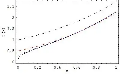

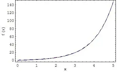

Below we plot $f(x)$ (solid), $e^x$ (dashed, black), and the approximations for $m=1$ (dashed, red), and $m=2$ (dashed, blue).
m = 1
m = 2
