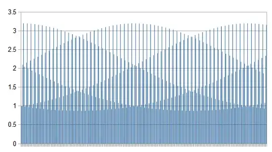

c = 1.1

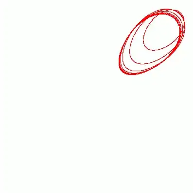

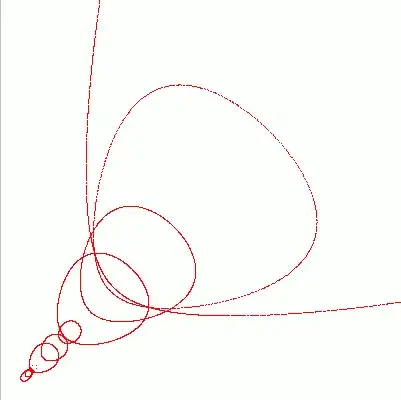

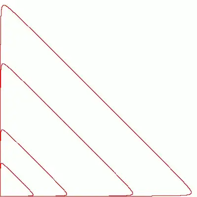

Computational evidence suggest the following conjectures.
For $1\ne c>0$ a sequence $\{z_n\}=\{(x_n,x_{n+1})\}$ is a dense set of a smooth curve which bounds a convex shape. When $c$ tends to infinity this shape tends to an isosceles right angled triangle with sides of order $c$, when $c$ tends to zero the shape tends to an ellipse, see the graphs.
$c=2^{-2}, 2^{-1},\dots, 2^7$ (I remark that the diameter of the shape is not a monotone function of $c$):
$c=2^{8}, \dots, 2^{11}$:
$c=2^{-3}, \dots, 2^{-22}$:
