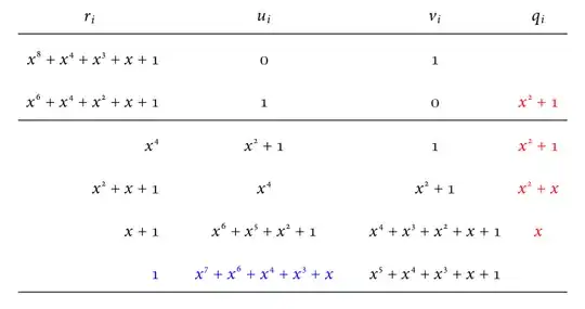

You have to find the inverse of elements. This is done with the *extended euclidean algorithm. Here is the top left corner as an example:
As a Bézout relation is \begin{multline*} (x^7 + x^6 + x^4 + x^3 + x)(x^6 + x^4 + x^2 + x + 1) \\+(x^5 +x^4 + x^3 + x + 1)(x^8 + x^4 + x^3 + x + 1 ) =1 \end{multline*} one has in $\mathbf F_2[x]/(x^8 + x^4 + x^3 + x + 1 )$: $$(x^6 + x^4 + x^2 + x + 1)^{-1}=x^7 + x^6 + x^4 + x^3 + x.$$
