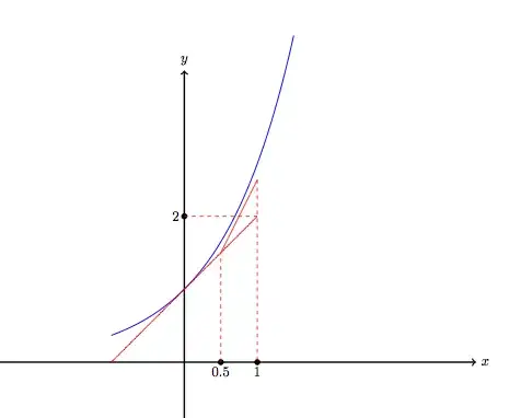

A simple geometrical representation can be given noting that $e=f(1)$ for a function $f(x)$ such that $f'(x)=f(x)$ and $f(0)=1$ (This can be a definition of $e$ derived from the definition of the exponential function as the function that represents an exponential growth).
So, representing a graphical approximation of the function (a representation of the Euler Method), as in the figure, We can see that $f(1)=e>2$

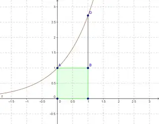

You could use the fact that $e^x$ is its derivative: $$ \int\limits_a^b e^x \, dx = e^b - e^a $$ So $$ e - 1 = \int\limits_0^1 e^x dx = \int\limits_0^1 \left(1 + (\underbrace{e^x - 1}_{\ge 0}) \right) dx > \int\limits_0^1 1\, dx = 1 $$ So $e - 1$ can be interpreted as the area beneath the curve $e^x$ from $x = 0$ to $x = 1$. This area can be divided into the area below the constant function $f(x) = 1$ (green square) and some non-zero area which corresponds to the area below the function $g(x) = e^x - 1 \ge 0$ (the area having the points $A$, $B$, $D$).
Area beneath the surface (Large version)
