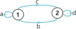

Sketch of proof. Each entry of $A^{2m}$ admits a combinatorial interpretation in terms of transition path on a 2-state space:
(For example, the path 1→1→1→2→2→2→1→2→1 contributes to the $(1,1)$-entry of $A^8$ with the term $aacddbcb = a^2b^2c^2d^2$.) Also, by the symmetry of $D$, we only need to consider terms with even exponents, i.e., of the form
$$\text{(coef.)}\cdot a^{2i}b^{2j}c^{2k}d^{2l}.$$
These terms correspond to paths where every transition takes place in even numbers. A moment of thought shows that such term corresponds to closed paths. Thus theses term only appear in $(1,1)$-entry and $(2,2)$-entry of $A^{2m}$, and the exponents of $b$ and $c$ are equal. Then $\text{(1)}$ follows by counting the number of such paths. ////
