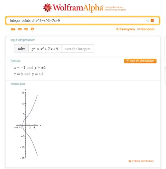

I am an unconditional admirer of WolframAlpha and for this reason I want to let the people of this error (or is it really the fault of mine?). If I'm not mistaken, I would be very happy to contribute, communicating this default calculation, to this extraordinary and beneficial website.
I was watching something on the cubic curve $$y^2=x^3+7x+9$$ More precisely I was interested in integer points $(x, y)$ with both coordinates being prime numbers. I thought having in hand the point $ (5,\pm 13) $ but, consulting WolphramAlpha, his answer gives only the two points $(-1,\pm 1)$ and $(0,\pm 3)$

    $5^{2} \ne 13^{3} + 7(13) + 9$..

    Perhaps OP meant (5,13) – user217285 Dec 19 '15 at 00:42
  • Absolutely! it is $(5,\pm13)$ – Ataulfo Dec 19 '15 at 00:46

  • Sure! I'm just trying to get the question visibility; I like it. I have no idea how to get WolframAlpha to find integer points, and I'm interested in finding out. The more I think about it, it might help to attach a concrete question, like "Can I use WolframAlpha to find integer points on an elliptic curve?" or something. I think that's what you're asking, but I'm not sure. – pjs36 Dec 19 '15 at 00:57

    For stuff on elliptic curves, the online Magma calculator is a much better choice than wolfram alpha. Throwing following commands Q<x> := PolynomialRing(Rationals());} E00 := EllipticCurve(x^3+7*x+9); Q00 := IntegralPoints(E00); Q00; to the online calculator, one get $(x,y) = (-1,\pm 1), (0, \pm 3), (5, \pm 13), (17, \pm 71), (27,\pm 141)$. – achille hui Dec 19 '15 at 01:24

  • I finally think that Wolfram was not wrong but gave answers ranging over a fixed interval (more so, I think it offers the possibility of extending its considered range) – Ataulfo Jan 16 '16 at 18:21
I believe wolfram is right, $$(-13)^3+7(-13)+9=-2279 \neq 5^2$$ and similarly $$13^3+7(13)+9=2297 \neq 5^2$$ and $\sqrt{2297} \notin \mathbb Z$
EDIT: Switching $x$ and $y$ it seems that $5^3+7(5)+9=13^2$, so yes you're correct!
