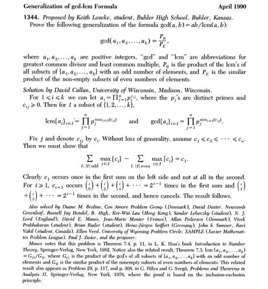

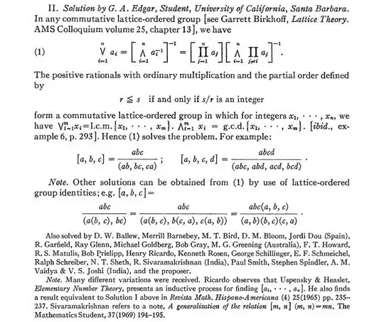

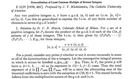

Such generalizations of gcd & lcm identities occur frequently as problems. Below are a couple of examples - which include references to prior literature, e.g. to an inclusion-exclusion max/min proof in Polya & Szego's problem book. They're problem E2229 from the Monthly 77 1970 p. 402 and problem 1344 from Math. Mag. 64 1990 p. 134.
alt text
alt text
alt text
