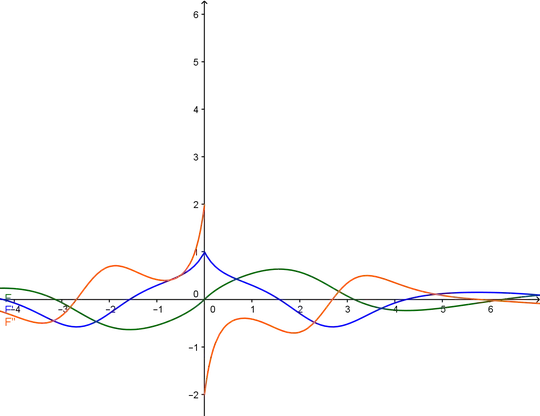

From graph:
Where green is $f$, blue is $f'$, orange is $f''$. $f'$ is clearly continuous but not differentiable at $0$
