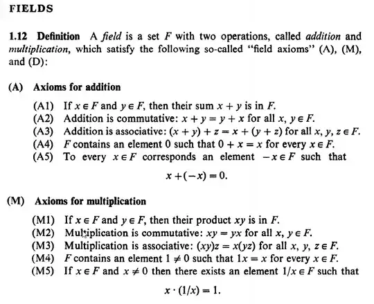

The following comes from Baby Rudin:
Is there any special reason as to why Rudin makes $1\neq 0$ a requirement? I've seen he uses this fact in a few elementary proofs below, the only consequence of this is excluding the $\{0\}$ field, right?

    It's not just Rudin, but a common requirement. And yes, its purpose is to exclude the trivial one-element field. – vadim123 Dec 12 '15 at 00:43

    Main reason if you ask me: You want the theorem "$R/I$ is a field $\Longleftrightarrow$ $I$ is a maximal ideal" to hold (where $R$ is a commutative ring and $I$ is an ideal). – darij grinberg Dec 12 '15 at 02:04

In algebraic geometry, fields loosely correspond to "points." The zero ring does not correspond to a point: instead, it corresponds to the empty set.
More practically, it just turns out that the zero ring doesn't behave like a field, so you shouldn't call it a field. For example, there's a unique module over the zero ring, namely the zero module. Modules over a field should be vector spaces, and there should be one for every possible dimension.
One way to write down the definition of field so that it naturally excludes the zero ring is that a field is a commutative ring with exactly two ideals. The zero ring only has one ideal. See also too simple to be simple.

Even simpler than Qiaochu Yuan's nice definition involving ideals, it's convenient and memorable to define a field as a ring whose non-zero elements form a group under multiplication. As groups can't be empty, that excludes the possibility that $0 = 1$.
