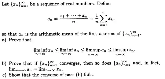

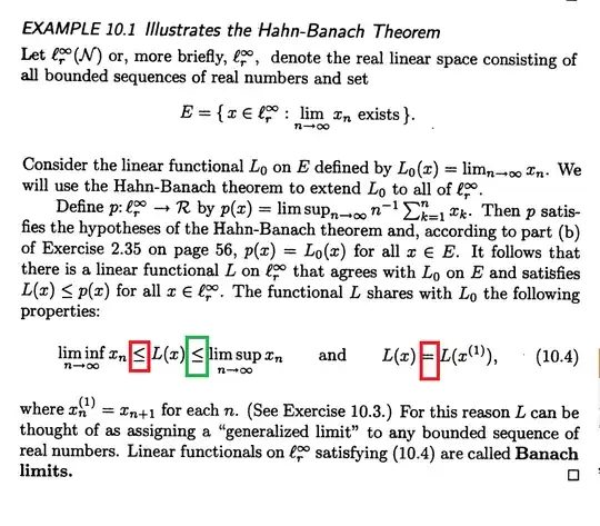

This problem is also given as an example in another book, there they use another sublinear functional. But I still have the same problem, the green inequality is the one I understand, the red I do not. It is given as en exercise in this book, and there is also a hint which I will show:
The hint given is relagted to an earlier exercise, in ordinary real analsyis that just deals with sequences:
But using this hint, I am still only able to get one inequality. Not the one with the $\liminf$, and also I am not able to get that $\lambda(a)=\lambda(L(a))$.

    For proving $L(x)=L(x^{(1)})$, isn't it enough to show $p(x-x^{(1)})=p(x^{(1)}-x)=0$? If $x_m$ is bounded, then shouldn't the average from $1$ to $n$ converge to the same limit as the average from $2$ to $n+1$? After all, $x_1/n$ and $x_{n+1}/n$ both converge to zero. Because of that, even if the sums don't converge to a limit for $x_m$, they still converge to zero for $x-x^{(1)}$. – ForgotALot Dec 12 '15 at 01:20
  • @ForgotALot Thank you very much. I think that works to solve that part yes, using what you do and then using $L(x-x^1)\le p(x-x^1)=0, L(x^1-x)\le p(x^1-x)=0$. That was very clever, thanks! – user119615 Dec 12 '15 at 01:37
    For the other inequality, use $-L((x_n))=L((-x_n)_n)\leq \limsup_n (-x_n)=-\liminf_n x_n$. – PhoemueX Dec 12 '15 at 07:04
  • @PhoemueX Thank you very much! – user119615 Dec 12 '15 at 15:21
