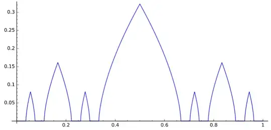

Let $C\subset [0,1]$ be the standard Cantor set. Define $$f(x)=(\operatorname{dist}(x,C))^{\alpha}$$ with $\alpha\in (0,1)$ to be chosen later. This is an $\alpha$-Hölder continuous function since it's a composition of the Lipschitz function $x\mapsto \operatorname{dist}(x,C)$ with the $\alpha$-Hölder function $t\mapsto t^\alpha$.
The complement of Cantor set has $2^{k-1}$ intervals of length $3^{-k}$, for each $k=1,2,\dots$. On such an interval, $f$ increases from $0$ to $(3^{-k}/2)^\alpha$ and then decreases to $0$. Therefore, its total variation is
$$ \sum_{k=1}^\infty 2^{k-1} (3^{-k}/2)^\alpha $$ and this series diverges when $\alpha\le \log 2/\log 3$.
This is a fairly simple function that you can sketch by hand. The case $\alpha = \log 2/\log 3$ is particularly nice: each new generation of peaks is half the height of the previous ones, so that the sum of heights is the same in each generation.
non-BV but Holder
