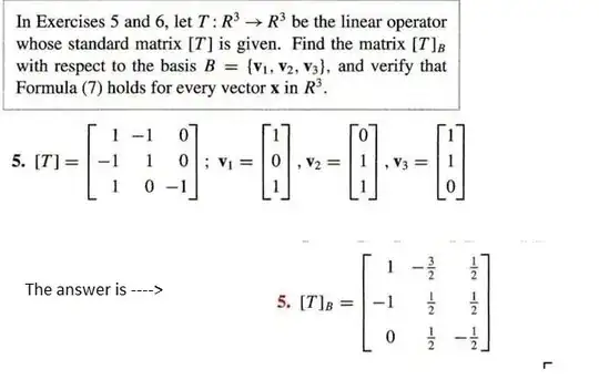

I tried to solve this question but the answer is totally different, can you explain how to solve it

  • @Павел Remember that the change of basis formula: $[T]B = [Id]{B\leftarrow C}[T]C[Id]{C\leftarrow B}$. So you just need to find the change of basis matrices and multiply. –  Dec 07 '15 at 18:11
  • Have you tried drawing a diagram of the transformation with respect to different bases OP? – Trajan Dec 07 '15 at 18:11
  • @Bye_World can you publish a photo with solution please, because I'm realy confused with this topic – Павел Dec 07 '15 at 18:36

Using all of that info above, let's take a look at your question. You're given $[T] = [T]_{\mathcal E}$ and you're given the basis $\mathcal B$ represented in its coordinates wrt to $\mathcal E$. That is, from your question we know that $$[\mathbf v_1]_{\mathcal E} = \pmatrix{1 \\ 0 \\ 1},\quad [\mathbf v_2]_{\mathcal E} = \pmatrix{0 \\ 1 \\ 1},\quad [\mathbf v_3]_{\mathcal E} = \pmatrix{1 \\ 1 \\ 0}$$ This is all we need to find $[T]_{\mathcal B}$. First we construct the change of basis matrix $[I]_{\mathcal E\leftarrow \mathcal B}$. But notice that it's just $$[I]_{\mathcal E\leftarrow \mathcal B} = \pmatrix{[\mathbf v_1]_{\mathcal E} & [\mathbf v_2]_{\mathcal E} & [\mathbf v_3]_{\mathcal E}} = \pmatrix{1 & 0 & 1 \\ 0 & 1 & 1 \\ 1 & 1 & 0}$$ Then of course because $[I]_{\mathcal B\leftarrow \mathcal E}$ undoes the action of $[I]_{\mathcal E\leftarrow \mathcal B}$, we can see that $$[I]_{\mathcal B\leftarrow \mathcal E} = \pmatrix{1 & 0 & 1 \\ 0 & 1 & 1 \\ 1 & 1 & 0}^{-1} = \frac 12\pmatrix{1 & -1 & 1 \\ -1 & 1 & 1 \\ 1 & 1 & -1}$$
Now that you have the change of basis matrices just multiply out $[T]_{\mathcal B} = [I]_{\mathcal B\leftarrow \mathcal E}[T]_{\mathcal E}[I]_{\mathcal E\leftarrow \mathcal B}$ to get $[T]_{\mathcal B}$. It's as easy as that. ;)
