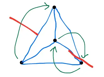

Here's a Schlegel diagram of the tetrahedron: Tetrahedron Rotation
The axis of rotation is in red, and it goes through opposite edges of the tetrahedron.
In general, the rotational symmetries of any Platonic Solid come in three flavors: Those with rotations axes
  • Through the centers of opposite faces,
  • Through the midpoints of opposite edges, and
  • Through opposite vertices.
The tetrahedron is unlike the other solids in that it's not centrally-symmetric: It doesn't have opposite faces and opposite vertices. Instead, across from every vertex, there's the center of a face. So the first and last kind of rotations above collapse into one, in a sense.
