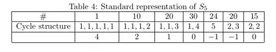

I am trying to determine the standard representation of $S_5$. I understand that it will be a map from group elements to $\mathbb{C}^4$. The character table is as follows.
I understand that the starting point is the permutation representation i.e. the map $\phi: S_5 \to \mathbb{C}^5$. The bases are $f_1 = \begin{pmatrix} 1 \\ 0 \\ 0 \\ 0 \\ 0 \end{pmatrix}$, $f_2 = \begin{pmatrix} 0 \\ 1 \\ 0 \\ 0 \\ 0 \end{pmatrix}$, $f_3 = \begin{pmatrix} 0 \\ 0 \\ 1 \\ 0 \\ 0 \end{pmatrix}$, $f_4 = \begin{pmatrix} 0 \\ 0 \\ 0 \\ 1 \\ 0 \end{pmatrix}$, $f_5 = \begin{pmatrix} 0 \\ 0 \\ 0 \\ 0 \\ 1 \end{pmatrix}$.
Then the standard representation is the map from the group elements to the complement of the one dimensional subspace in $\mathbb{C}^5$. This vector space $V$ is as follows.
$$ V = \{(x_1, x_2, \dots, x_n) | x_1 + x_2 + \ldots + x_n\} $$
What should be my next step if I want to work out the matrices corresponding to the group elements in the standard representation? I understand that their might be more than one choices of basis vectors. What is the most straightforward choices for basis vectors?
