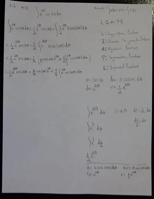

Evaluate $$\int e^{2\theta} \sin (3\theta)\ d\theta .$$
I am little stuck as to what I can do after this point. Please tell me if my method overall is flawed:

    Notice that you have an integral on the right-hand side which is the same as that on the left-hand side, and it's the one unknown in the equation. So solve the equation for the unknown integral. – Matthew Leingang Dec 02 '15 at 15:34

If you denote $I := \int e^{2 \theta} \sin 3 \theta$, then your computation using integration by parts twice (which is the standard approach, and a reasonable one) says that $$I = f(\theta) + \frac{9}{4} I$$ for some function $f$ that does not involve an integral. (Perhaps there is a sign error in your formula, but this does not affect the applicability of our method:) Hence by algebra we can simply solve for $I$ (i.e., evaluate the integral) in terms of $f$. (Don't forget to include the general constant, i.e, the "$+ C$", which should appear in the formula for your general antiderivative but does not appear in the above equality because, as usual, we interpret $I$ to be a family of functions, all equal up to an overall constant.)

You have some mistake: $$ \int e^{2\theta}\sin(3\theta) d\theta=\frac{1}{2}e^{2\theta}\sin(3\theta)-\frac{3}{2}\int e^{2\theta}\cos(3\theta) d\theta= $$ $$ =\frac{1}{2}e^{2\theta}\sin(3\theta)-\frac{3}{4} e^{2\theta}\cos(3\theta) -\frac{9}{4}\int e^{2\theta}\sin(3\theta) d\theta $$ so: $$ \left(1+\frac{9}{4} \right)\int e^{2\theta}\sin(3\theta) d\theta=\frac{1}{2}e^{2\theta}\sin(3\theta)-\frac{3}{4} e^{2\theta}\cos(3\theta) $$ and $$ \int e^{2\theta}\sin(3\theta) d\theta=\frac{e^{2\theta}}{13}\left(2\sin(3\theta)-3\cos(3\theta)\right) $$
