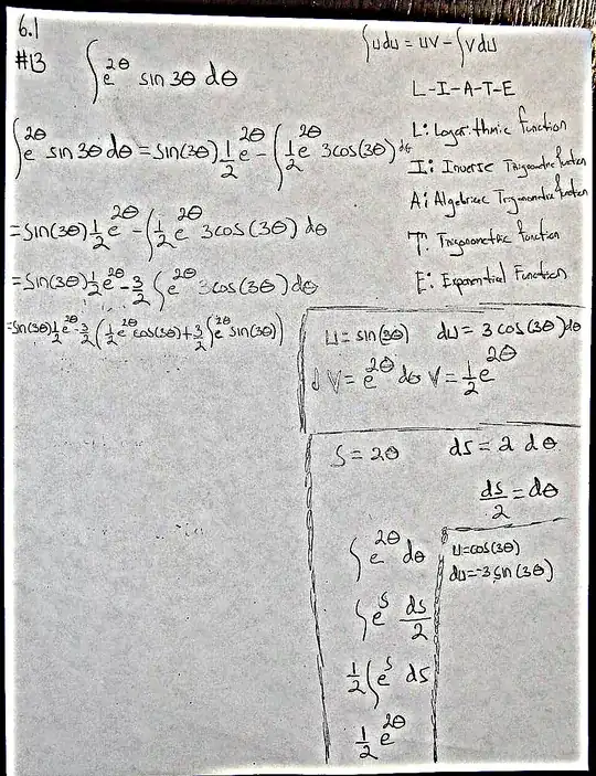

$$\int e^{2\theta}\sin(3\theta)\ d\theta$$ I don't know where to stop when it comes to questions such as this? Can you make me aware? I believe there was a possible prior person who answered the same question but they failed to indicate what the
I was and in the larger scheme of things why there was no need to further integrate or utilize another method to integrate.

This is a standard example of integrating by parts and getting back to the function you started with. You get $$\int = A - B\int$$ where it's the same integral both times. So you rearrange it as $$\int+B\int = A$$ then as $$(1+B)\int = A$$ and finally as $$\int = \frac A {1+B}.$$ – Michael Hardy Dec 20 '15 at 16:25
