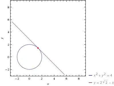

For visual confirmation of the above tangent line, here's a graph from Wolfram Alpha:
