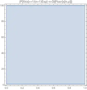

Update: Here is the region in which the conjecture holds numerically, by Mathematica: Where the conjecture holds
