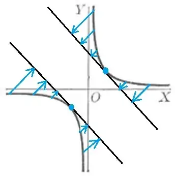

The line $x+y=2$ is tangent to the branch of the hyperbola in the first quadrant, and the line $x+y=-2$ is tangent to the branch in the third quadrant, as in the (rather crude) picture below:
hyperbola with tangent lines
Project the upper branch of the hyperbola at $45^\circ$ down and to the left onto the upper tangent line, and project the lower branch of the hyperbola at $45^\circ$ up and to the right onto the lower tangent line, as indicated by the blue arrows.

  • @Slade Thank you for your answers! If I wanted to explicitly write the orthogonal projection how would I do this? Could I have a reference or a link on how to project a function? – Monolite Nov 25 '15 at 14:22
    @Monolite: It’s probably easier here to compute the inverse of the projection. Start at a point $\langle x,2-x\rangle$ on the upper line, for instance. If you move northeast perpendicular to the line, you go through points of the form $\langle a+x,a+2-x\rangle$. You hit the hyperbola when $(a+x)(a+2-x)=1$, which can be rearranged to $a^2+2a-(x-1)^2=0$. Since $a\ge 0$, this gives us $a=-1+\sqrt{1+(x-1)^2}$, so $\langle x,2-x\rangle$ corresponds to $$\langle x-1+\sqrt{1+(x-1)^2}, 1+\sqrt{1+(x-1)^2}-x\rangle$$ on the hyperbola. You can do the same sort of thing for the other line. – Brian M. Scott Nov 25 '15 at 21:21
  • Thank you so much Brian that all made sense! Just to see if I got it: if I wanted to project my point in the direction of $y = x+1$ instead of $y=x$ I would obtain the points $\langle a+1+x,a+2-x\rangle$ right? Now I am left with the doubt on how I write the homeomorphism explicitly though since I can't do this procedure for infinite points. – Monolite Nov 25 '15 at 21:49
    @Monolite: You’re very welcome. What I wrote there actually gives you a formula for a homeomorphism from the upper line to the upper branch of the hyperbola: $$h(\langle x,2-x\rangle)=\left\langle x-1+\sqrt{1+(x-1)^2}, 1+\sqrt{1+(x-1)^2}-x\right\rangle;.$$ – Brian M. Scott Nov 25 '15 at 21:55
