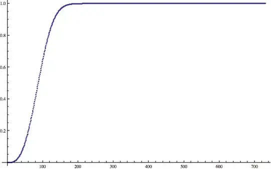

Here is a plot from $n=0$ to $n=730$. For $n\lt3$, the probability of getting a triple is $0$, and for $n\gt730$, the probability is $1$.
