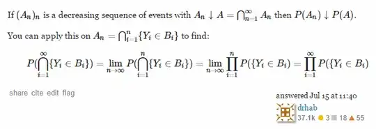

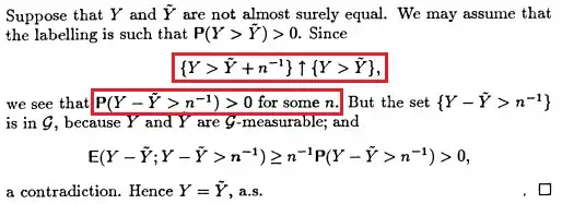

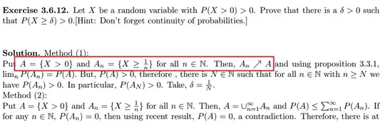

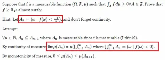

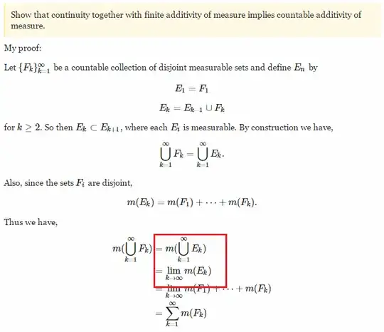

Some examples:
  1. Used in the proof of $P(\liminf A_n) \le \liminf P(A_n) \le \limsup P(A_n) \le P(\limsup A_n):$
$$P(\liminf (A_n)) = \lim_{N \to \infty}P(\bigcap_{n \ge N} A_n)$$

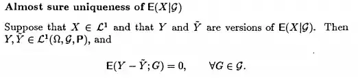

  1. Uniqueness of conditional expectation (Williams' Probability w/ Martingales)
  1. From Rosenthal's book:
  1. A property of independence of random variables
  1. Continuity of 'measure' proves countable additivity:
  1. Another example
