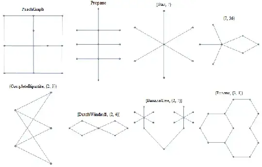

After a quick look at GraphData[] in Mathematica, here are some simple graphs with eigenvalues of $\sqrt{6}$. That value is also in their spectrum.
some graphs with eigenvalue sqrt(6)

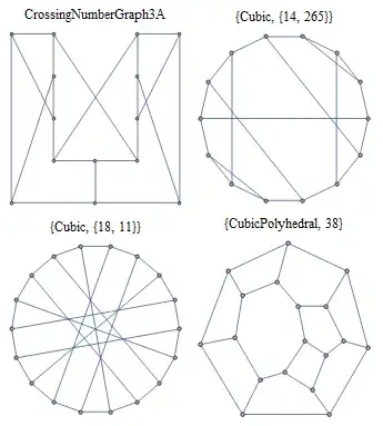

Ah, you're asking for cubic graphs. Same process:
cubic graphs with eigenvalue sqrt(6)
