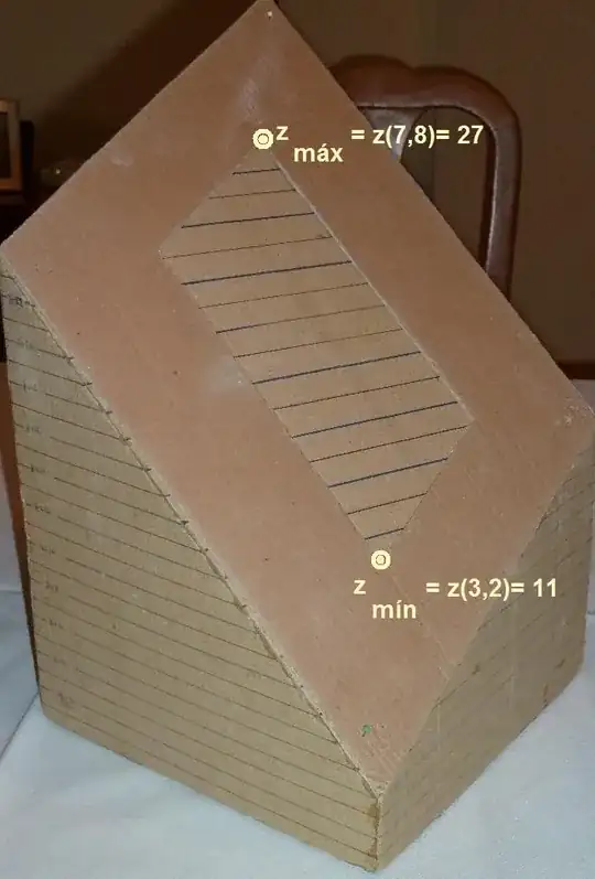

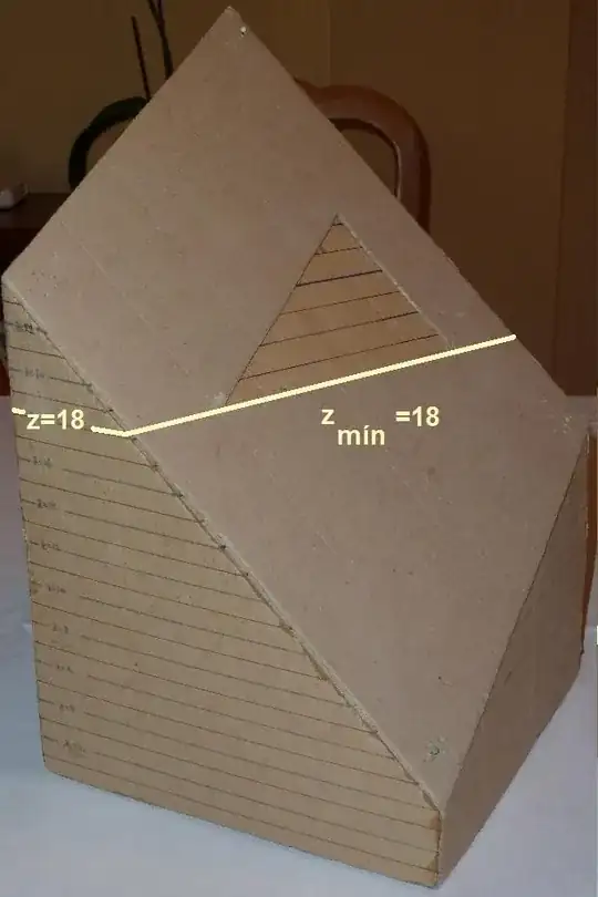

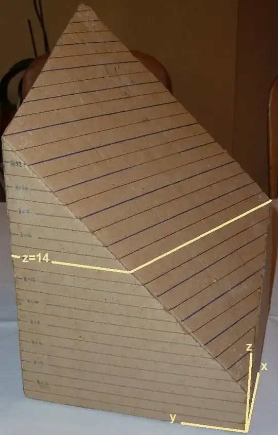

Sometimes one picture is better than a thousand words linear function with level lines
max and min of the function
min along the side
