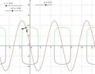

Here is a first image:
first impression (Large version)

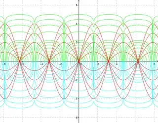

Here is another one:
more curves (Large version)

    Half the curves are missing, but you can get them back by taking the absolute value inside the log: $y=\pm\sqrt{2\ln\lvert\cos x\rvert+d}$. –  Nov 03 '15 at 17:30
  • @Rahul Thank you very much Rahul, that extends the solutions along the $x$-axis. Any idea how to get the curves with small "radius"? – mvw Nov 03 '15 at 17:34
    Just take $d$ to be very small but positive. The radius is roughly $\sqrt d$. –  Nov 03 '15 at 17:37
  • Rahul: Again you seem right, thanks! I was fooled by the slider spacing I used to play around with it in GeoGebra, see the first picture. – mvw Nov 03 '15 at 17:40
  • Nice diagrams ! – Simon S Nov 03 '15 at 18:20
  • I used GeoGebra for the diagrams. The more I use it, the more I like it. – mvw Nov 03 '15 at 19:00
