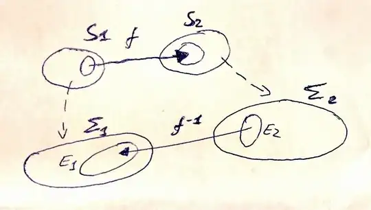

I made a sketch of the 1st definition of this measurable function, and my picture does not seems to be coherent with what I naturally want to find. enter image description here
I mean for me it would be natural to define that $f^{-1}$ goes back the same route from which it started ($S_2 \to S_1$).

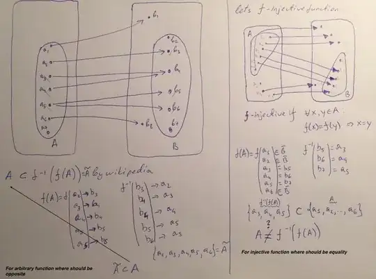

So, in order to understand this better I wanted at least to show myself visually that this holds.
I have included picture of my thoughts which give me completely opposite result. Should I post this as separate question? enter image description here
