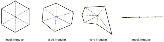

I need to evaluate the quality of a list of machine parts, which roughly has one center point surrounded by 6 exterior points. If the quality is good, then the 6 exterior points will form a regular hexagon and the center point will locate in the very center of the hexagon; but if the quality is low, then either the exterior points will form an irregular hexagon, or the center point is not in the center of the hexagon, or both. So I need to measure the irregularity of a given hexagon.
Intuitively, a regular hexagon should be the least irregular; other hexagons should be more irregular; and when the seven points form a line, this should be the most irregular. I drawed a figure to illustrate this: (The center point is in red and the exterior points are in yellow)
hexagon irregularity
Note: the center point is not necessarily located in the center of the hexagon, and its position also affects the irregularity.

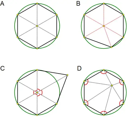

I have tried the following definitions. First let's define the distance between the center point to the 6 exterior points as the radii (there are 6 radii for each hexagon). I drawed another figure to illustrate these ideas:
possible definitions
  1. Define the coefficient of variance (CV) of the 6 radii as the hexagon irregularity. Then the hexagon B will have the same irregularity as hexagon A (regular hexagon).
  2. Define the CV of the 6 angles spanned by the center point to exterior points as the hexagon irregularity. Then the hexagon C will have the same irregularity as the hexagon A.
  3. Define the CV of the 6 internal angles as the hexagon irregularity. Then the hexagon D will have the same irregularity as the hexagon A. (Yes, the location of the center point also counts. )
  4. Define the CV of the 6 edges as the hexagon irregularity. It's obviously not working, otherwise the hexagon can be squeezed without changing its irregularity.
  5. Define the CV of both the 6 edges and the 6 radii as the hexagon irregularity. It seems working, but I failed to prove its boundedness.
By far Definition 5 seems to be the best and is practically useful. However, I would like to know if there are better definitions.
