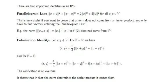

So suppose we are given a norm on a vector space.
If the Parallelogram law holds does that automatically mean we have the inner product which we can find using the Polarisation identity? Or is showing the Parallelogram law holds not sufficient to show that there exists an associated inner product?
Also, given that the Parallelgram law fails, e.g. $\Vert(x_1,x_2)\Vert_1 = |x_1| + |x_2|$ in $\ell^1(2)$, is there any significance in considering the Polarisation identity?

    The validity of the Parallelogram Law is a necessary and sufficient condition for the existence of a scalar product inducing the given norm, and in the affirmative case the scalar product is uniquely determined by the Polarization identity. I have to search a reference perhaps Serge Lang Real and Functional Analysis. – agt May 26 '12 at 17:10

    I don't get what you are trying to say. Suppose we know the vector space and the norm. The definition of the "angle" is only available to us if the inner product actually exists, which is not always the case. For example,how you would you go about finding the angle of the 1-norm space as in the OP? Anyway, the (somewhat nice) conclusion of all this is that, given a NLS, the Parallelogram Law determines IF there even exists such an inner product. If there does, then the Polarisation Identity tells us EXACTLY what the inner product (we want) is! Proving all this is a different (but doable) task. – Adam Rubinson May 27 '12 at 11:55
