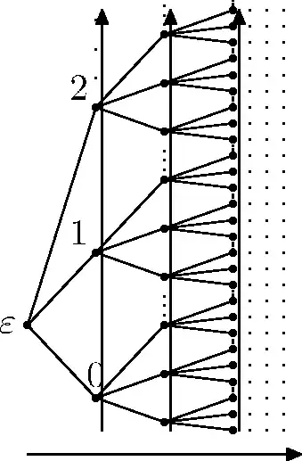

I am not sure to which extent it's useful here, but I'll add one possible graphical representation of $\omega^\omega$, since I've mentioned this ordinal a few times.
Imagine all finite sequences of non-negative integers ordered as in the picture: first from left to right (by the length) and in each column from bottom to top (lexicographically). The symbol $\varepsilon$ represents empty sequence, each point represents the sequence given by the path from root to this dot.
It should be at least clear that in the first column we have $\omega$, in the second column $\omega^2$ etc. (Since $\omega+\omega^2=\omega^2$, if we take all points up to second column, we get still $\omega^2$.) So clearly the ordinal in the picture is at least $\sup\{\omega^n; n<\omega\}$. If you think about it a little bit, you'll find out that this ordinal is the union of $\omega^n$'s, if $\omega^n$ is represented by the first $n$ columns.
omega to omega
