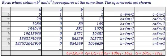

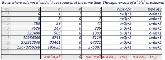

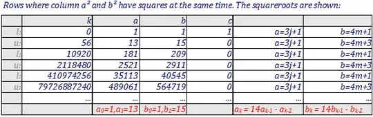

Here are three tables for the matches of columns $a,c$, $b,c$ and $a,b$ The only threefold match $a,b,c$ is $k=0,a^2=b^2=c^2=1$
table a_c:
The recursion for the $k$-entries is $k_0=0,k_1=8$, $k_{i+2}=34 k_{i+1} - k_i + 8$
table _bc:
The recursion for the $k$-entries is $k_0=0,k_1=20$, $k_{i+2}=98 k_{i+1} - k_i + 20 $
table ab_:
The recursion for the $k$-entries is $k_0=0,k_1=56$, $k_{i+2}=194 k_{i+1} - k_i + 56 $
