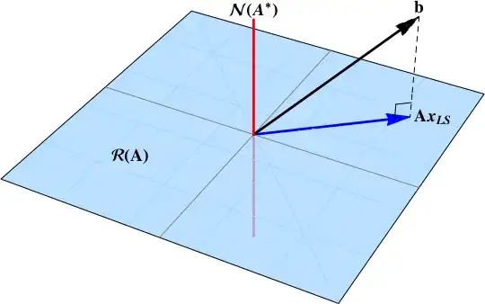

When does the least squares solution exist?
$$\mathbf{A}x = b$$
$$\mathbf{A} \in \mathbb{C}^{m\times n}_{\rho}, \qquad b \in \mathbb{C}^{m}, \qquad x \in \mathbb{C}^{n}$$
In short, when the data vector $b$ is not in the null space: $$ b\notin\color{red}{\mathcal{N}\left( \mathbf{A}^{*} \right)} $$ The least squares solution is the projection of the data vector $b$ onto the range space $\color{blue}{\mathcal{R}\left( \mathbf{A}\right)}$. A projection will exist provided that some component of the data vector is in the range space.
Projection
This post works through a derivation of the least squares solution based upon the singular value decomposition of a nonzero matrix. How does the SVD solve the least squares problem?
Another approach is to start with the guaranteed existence of the singular value decomposition $$ \mathbf{A} = \mathbf{U} \, \Sigma \, \mathbf{V}^{*}, $$ and build the Moore-Penrose pseudoinverse $$\mathbf{A}^{+} = \mathbf{V} \Sigma^{+} \mathbf{U}^{*}.$$ The pseudoinverse is a matrix projection operator onto the range space $\color{blue}{\mathcal{R}\left( \mathbf{A}\right)}$.
