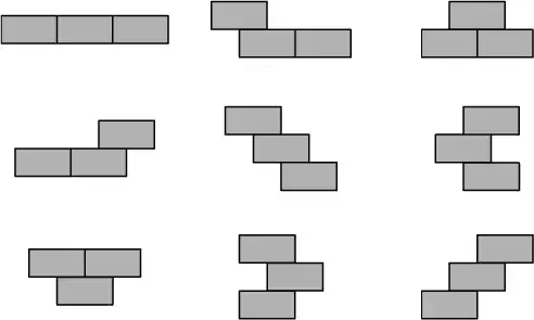

We have $f(3)=9$ because
$\qquad\qquad$enter image description here
So, it seems that we can have $f(n)=3^{n-1}$. However, I have not been able to prove that.

This result is contained in Corollary 5.3 in [1]:
The number of directed animals on the square lattice of size $n$ with [...] compact sources, is $3^{n-1}.$
Exercise for the reader: Show that the rectangle piling problem on $n$ tiles proposed here is equivalent to counting directed animals of size $n$ on the 2-dimensional square lattice with compact sources.

What makes this problem different from the above is a gravity condition. It allows this position:
o o X
X X
but does not allow this position:
o X X
X o
Consequently, all I can conclude from the above reference is that Voge/Guttman's values are upper bounds for the desired numbers. The gravity condition may make the problem harder or easier, it is hard to tell at first glance. My guess is harder, and my followup guess is that the powers-of-three pattern identified is a coincidence.
vadim123
  • 83,937
  • Where is there a gravity condition? I don't see one stated in the OP. – Brian Tung Oct 12 '15 at 17:15
  • Gravity is implicit in the problem; each rectangle must rest on something. Take the second or fourth examples and reflect them in a horizontal line to get the forbidden positions. Including these would bring the total to 11, which matches the Voge/Guttman table. – vadim123 Oct 12 '15 at 17:22
  • Ahh, well, I took gravity to mean actual stability. For instance, the very last example in OP is not stable: It should tip to the right and fall down. If you mean by gravity only that each rectangle must overlap a rectangle below it by $1/2$, then yes, I see that. – Brian Tung Oct 12 '15 at 17:24
  • A stability condition would be considerably stronger than the gravity condition here; only two of the nine given arrangements are stable. – vadim123 Oct 12 '15 at 17:26
  • I know (well, I treat exact $1/2$ overlaps as quasi-stable), but I consider "gravity" as used ordinarily to include "stability." Anyway, now I know what you mean. – Brian Tung Oct 12 '15 at 17:30
