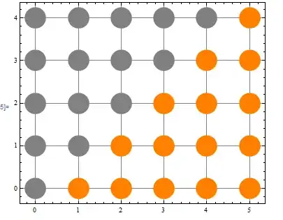

The sample space is the grid of points $\{0,1,2,3,4,5\} \times \{0,1,2,3,4\}$, corresponding to $(H_A, H_B)$. Orange dots are those where $A$ wins. There are as many gray dots as orange dots.
$H_A$ and $H_B$ are independent symmetric binomial random variables, hence $$\begin{eqnarray} \mathbb{P}(H_A = h_a, H_B = h_b) &\stackrel{\text{independent}}{=}& \mathbb{P}(H_A = h_a)\mathbb{P}( H_B = h_b) \\ &\stackrel{\text{symmetry}}{=}& \mathbb{P}(H_A = 5-h_a)\mathbb{P}( H_B =4- h_b) \\ &=& \mathbb{P}(H_A = 5-h_a, H_B = 4-h_b) \end{eqnarray}$$ But $(h_a, h_b) \mapsto (5-h_a, 4-h_b)$ interchanges orange and gray dots, therefore the total probability of $A$ winning (orange dots) is $\frac{1}{2}$.
Sasha
  • 71,686
    Beautiful. May I ask how you created the nice graphic? – bgins May 18 '12 at 19:42
    @bgins I used Mathematica, Graphics[Table[{If[h1 > h2, Orange, Gray], Disk[{h1, h2}, 1/4]}, {h1, 0, 5}, {h2, 0, 4}], GridLines -> {Range[0, 5], Range[0, 4]}, Frame -> True]. – Sasha May 18 '12 at 19:43
  • Splendid answer. – Brian M. Scott May 18 '12 at 19:50
    Don't we need to account for the fact that dot at $(a,b)$ has non-uniform probability, namely $$\frac{{5\choose a}}{2^5}\cdot\frac{{4\choose b}}{2^4},?$$ Don't we need a symmetry argument for why the orange parts have the same weight as the grey parts? – bgins May 18 '12 at 19:53
    @bgins Yes! But the symmetry $(a,b) \to (5-a,4-b)$ is what matters. – Sasha May 18 '12 at 19:56
  • Yup, that's it alright! – bgins May 18 '12 at 19:57
  • @Sasha: shouldn't that symmetry argument be mentioned somewhere in the answer, or is it obvious? – Neil G May 18 '12 at 22:10
    @NeilG It should be. I will extend the answer once I have a chance. – Sasha May 18 '12 at 22:11
