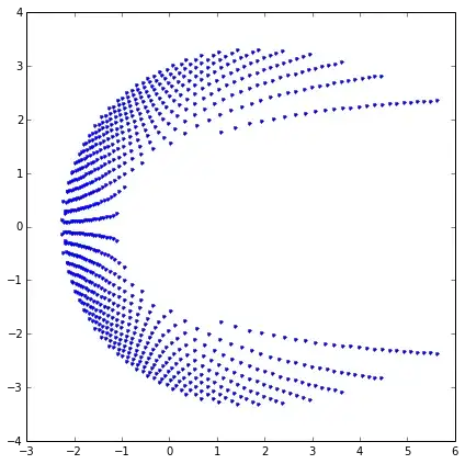

The roots go off to infinity. One can show the roots of $\displaystyle f(z) = \sum_{k=0}^{N-1} \frac{z^k}{k!}$ tend to a curve $|z e^{1-z}| = 1$ if you rescale by a factor of $N$.
Please see
I even wrote a paper on the topic myself on the roots of truncated cosine. [1] Here's a chart I produced for this occasion where you can see the linear outward drift of the roots.
Here is the numpy code I used to produce it. Mathematica or Pari might be better suited.
import numpy as np
plt.rcParams['figure.figsize']=7,7
for N in range(10, 60, 2):
    A = 1j*np.zeros((N,N))
    t =  np.arange(N-1)
    A[t+1, t] = 1.0/(N-t)
    a = np.ones(N)
    A[np.arange(N),-1] = -a[::-1]
    z = 1/np.linalg.eig(A)[0]/np.sqrt(N)
    plt.plot(z.real, z.imag, 'b.')
