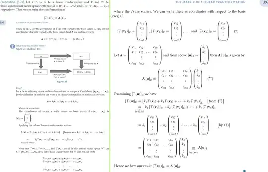

Kuldeep Singh's Linear Algebra: Step by Step (2013) illustrates this with Figure 5.31 at p 396. But I'll post pp 395-397.
