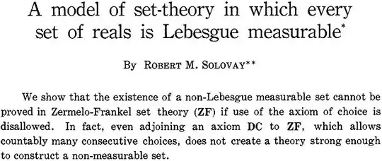

Peter LeFanu Lumsdaine points out in a comment that the result is due to Robert Solovay. The 1970 article is on JSTOR, and begins as follows:
alt text

    Yes, it is indeed consistent with ZF that all sets are Lebesgue measurable — this is a beautiful construction due to Robert Solovay. So the construction of any non-measurable set does indeed require Choice. – Peter LeFanu Lumsdaine Dec 16 '10 at 22:42
