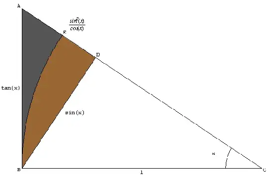

Here is an attempt at a geometric proof.
alt text
(Figure thanks to J.M)
Consider $\triangle ABC$ such that $\angle{BCA} = x$. Let $BC=1$ and so $AB = \tan x$.
Let $BE$ be the arc of radius 1 and angle $x$ drawn with $C$ as the center (note that $E$ is on AC, between $A$ and $D$ and is kind of hidden in the brown region). Note that $CE = 1$.
Now the area of the gray region is $\dfrac{\tan x}{2} - \dfrac{x}{2}$ (area of $\triangle ABC$ - area of the sector $CBE$).
Let $D$ be the perpendicular on the hypotenuse $AC$ from $B$. It can be seen that $CD = \cos x$ and thus distance from $D$ to $C$ is less than distance from $E$ to $C$ (which is $1$).
Thus the area of the gray region is less than the area of $\triangle BAD$ (gray + brown).
Now $AD = \dfrac{\sin^2 x}{\cos x}$ and thus we have that
$$ 0 < \dfrac{\tan x - x}{2} \lt \dfrac{\sin^3 x}{2\cos x}$$
And so
$$ 0 < \dfrac{\tan x - x}{2x^2} \lt \dfrac{\sin^3 x}{2x^2 \cos x}$$
Since we know that $\lim_{x \to 0+} \dfrac{\sin x}{x} = 1$, and that $\dfrac{\tan x - x}{x^2}$ is an odd function, that the limit is $0$, follows.
