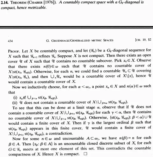

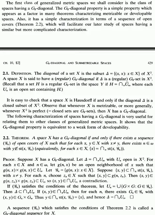

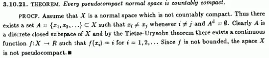

ii $\Rightarrow$ i. If $X$ is a Tychonoff space and each continuous real-valued function on the space $X$ is bounded, then the space $X$ is called pseudocompact. A topological space $X$ is countably compact if each infinite subset of $X$ has a cluster point. Each compact space is countably compact and each countably compact space is pseudocompact, and both inclusions are strict. But for metric spaces these conditions coincide. It is well-known because each normal pseudocompact space is countably compact [Eng] and each countably compact regular space with $G_\delta$-diagonal is a metrizable compact [Gru].

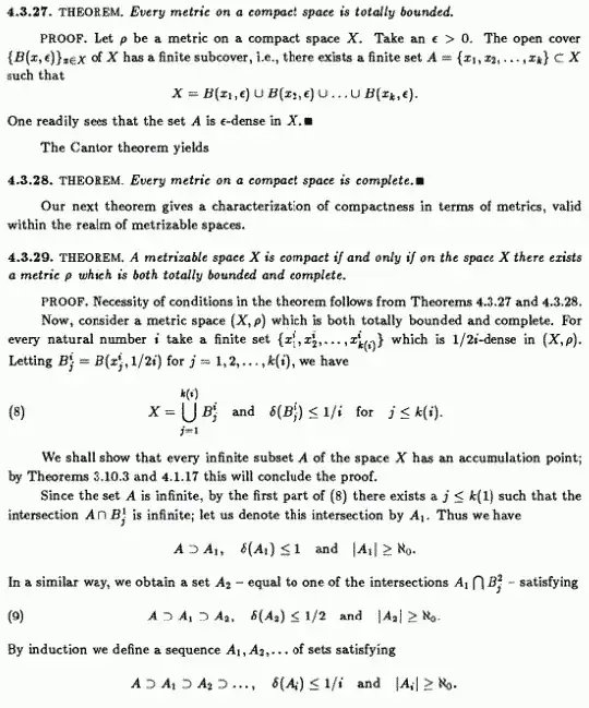

But we can give a direct proof. By Theorems 4.3.27-29 from [Eng], a metric space $(X,d)$ space is compact iff $(X,d)$ is complete and totally bounded.
If the space $(X,d)$ is not complete then let $(X’, d’)$ be a completion of the space $(X,d)$. Since the space $(X,d)$ is incomplete, there exists a point $x_0\in X'\setminus X$. Consider a function $f$ such that $f(x)=1/d’(x,x_0)$ for all $x\in X$. Since $d’$ is a extension of the metric $d$, and $x_0\not \in X$, the function $f$ is continuous. The density of the set $X$ in the space $X'$ imply that the function $f$ is unbounded.
If the space $(X,d)$ is not totally bounded, then there exist a number $\varepsilon>0$ and a infinite subset $X_0=\{x_n\}$ of the space $X$ such that $d(x_m, x_n)\ge 3\varepsilon$ for each pair of distinct indices $m$ and $n$. Then $X_0$ is a closed discrete subset of the space $X$ so a function $f_0:X_0\to\Bbb R$, $f_0(x_n)=n\varepsilon$ is continuous. We can extend the function $f_0$ to a continuous function $f$ from $X$ to $\Bbb R$ by Tietze-Urysohn theorem, of directly, by putting for each $x\in X$
$$f(x)=\sum_{n=1}^\infty \max\{0, n(\varepsilon - d(x,x_n)) \}. $$

[Gru] Gary Gruenhage Generalized Metric Spaces, in: K.Kunen, J.E.Vaughan (eds.) Handbook of Set-theoretic Topology, Elsevier Science Publishers B.V., 1984.
