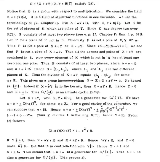

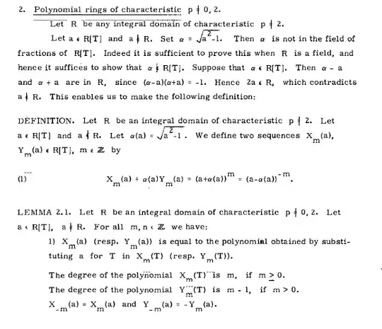

EDIT:
At the paper that I am looking I found the corresponding lemma for the case that the characteristic is not $2$ and its proof:
PROOF.
I want to try to do the same for the case $\text{char}=2$ but first I have to clarify some points at the proof above.
Why do we consider the field $K=R(t)(a)$?
Is $S$ the set of points at which the functions of $K$ are not defined?

  • How do we conclude that $\text{deg}X=\text{deg}a+\text{deg}Y$ or $\text{deg}Y=\text{deg}a+\text{deg}X$?$$\text{deg}(X^2+aXY+Y^2)=\text{deg}1=0\ \Rightarrow\max{\text{deg} (X^2),\text{deg} (aXY),\text{deg} (Y^2)=0\ \Rightarrow\max{2\text{deg}X,\text{deg}a+\text{deg}X+\text{deg} Y,2\text{deg} Y}=0$$ If $\max =2\text{deg}X$ or $\max =2\text{deg}Y$ then $\text{deg}X=0$ or $\text{deg}Y=0$.But then $\text{deg}a+\text{deg}X+\text{deg}Y=\text{deg}a \geq 0$.So it must be $\max =\text{deg}a+\text{deg}X+\text{deg}Y$,i.e.,$\text{deg}a+\text{deg}X+\text{deg}Y=0$. But this isn't the desired result.Or? – Mary Star Sep 26 '15 at 23:12
  • the two terms of highest degree have to cancel each other so that the sum is $1$. If $\deg X = \deg Y$ then the middle term has highest degree and can'tbe cancelled by anyone, so that's impossible. So for example $\deg X > \deg Y$ and then the first two terms have to have the same degree hence $\deg X = \deg Y + \deg a$ – mercio Sep 27 '15 at 01:27
  • Ok... I see... Why do we take then $X'=X+aY$ ? – Mary Star Sep 27 '15 at 21:06
  • because when you fix $Y$, the equation is a quadratic in $X$ so it has two solutions $(X_1,Y)$ and $(X_2,Y)$. Then it's natural to investigate the involution that permutes $X_1$ with $X_2$.. Also there are two obvious ways to put a commutative group structure on the set of solutions, and (modulo switching $X$ with $Y$), this operation is just adding or substracting the fundamental solution such that we get closer to the identity element of the group. – mercio Sep 27 '15 at 21:21
  • I have to think about it... At the paper that I am looking I found the corresponding lemma for the case that the characteristic is not $2$ and its proof, I added it in my initial post above. Could you take a look at it? – Mary Star Sep 28 '15 at 02:38
