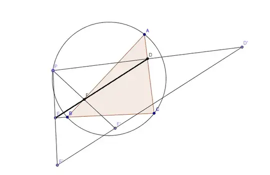

By playing around with a few diagrams, I noticed that by reflecting $P$ in the sides of the triangle, it seems to me that I get a set of three collinear points.
Is my guess actually a theorem, or is it just plain wrong? In the case that it is actually true, then how would one go from the Simson line to deducing that the reflections are also collinear? I suspect there may be a relationship between the two concepts.

Do you know homothety? Then your observation is just a homothety away from simson line.
In the diagram above $DEF$ is the simson line. Apply an homothety with center P and ratio $2$ and Voila! $D'E'F'$ is a straight line too.
In other words the ratios $PD \over PD'$ = $PE \over PE'$ = $PF \over PF'$ =$0.5$. Since D,E,F are collinear, so are D', E', F'
