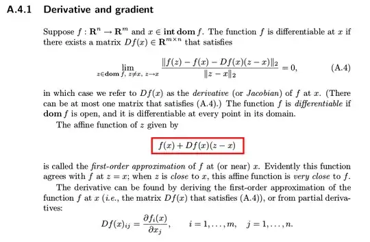

I am studying Boyd & Vandenberghe's Convex Optimization and encountered a problem on page 642. According to the definition, the derivative $Df(x)$ has the form:
$$f(x)+Df(x)(z-x)$$
and when $f$ is real-valued (i.e., $f : \Bbb R^n \to \Bbb R$), the gradient is
$$\nabla{f(x)}=Df(x)^{T}$$
See the original text below:

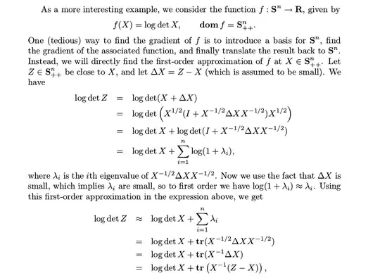

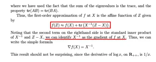

But when discussing the gradient of function $f(X)=\log{\det{X}}$, author said "we can identify $X^{-1}$ as the gradient of $f$ at $X$", please see below:
Where did trace $\mbox{tr}(\cdot)$ go?

    In the general formula, $Df(x)(z-x)$ is actually the scalar product $\langle Df(x),z-x\rangle$. In the example, the scalar product is $\langle U,V\rangle=\mathrm{tr}(UV)$, hence indeed the gradient at $X$ is $Df(X)=X^{-1}$. – Did Sep 23 '15 at 07:34
    Hi, Did. You mean this is just a trivial problem caused by the notation? – BioCoder Sep 23 '15 at 07:44
    Yes, and probably by failing to note that $Df(x)(z-x)$ stands for $\langle Df(x),z-x\rangle$. – Did Sep 23 '15 at 07:46
  • Well, it sounds plausible. But $Df(x) \in R^{m\times{n}}$ is a matrix and $(z-x) \in R^n$ is a vector, can $Df(x)(z−x)$ still be interpreted as $⟨Df(x),z−x⟩$ ? – BioCoder Sep 23 '15 at 07:55
    Yes, because $m=1$ hence $Df(x)$ and $z-x$ are both vectors in $R^n$. – Did Sep 23 '15 at 07:58

First of all, if you write (for a general function $f: U \to \mathbb R$, where $U \subset \mathbb R^K$)
$$f(y) \approx f(x) + Df(x) (y-x),$$
then term $Df(x) (y-x)$ is really
$$\sum_{i=1}^K D_i f \ (y_i - x_i).$$
Now the function $Z\mapsto \log\det (Z)$ are defined on an open set $S^n_{++}$ in $\mathbb R^{n^2}$, so it has $n^2$ coordinate given by $Z_{ij}$, where $i, j = 1, \cdots, n$.
Now take a look at
$$\begin{split} \text{tr} \left( X^{-1} (Z-X)\right) &= \sum_{i=1}^n \left(X^{-1} (Z-X) \right)_{ii}\\ &= \sum_{i=1}^n \sum_{j=1}^n X^{-1}_{ij} (Z_{ji}-X_{ji}) \\ \end{split}$$
Thus we should have identified $(X^{-1})^T$ as the gradient of $\log \det$.
  • As Did said, the second term of the first-order approximation $f(x)+Df(x)(z−x)$ is actually an inner product of the derivative $Df(x)$ and $(z-x)$, but why is it written as $Df(x)(z-x)$ instead of $⟨Df(x),z−x⟩$ ? After all, the inner product is $Df(x)^T(z-x)$ – BioCoder Sep 24 '15 at 03:49
    That corresponds to matrix multiplication. You can think of $Df(x)$ as a $1\times n$ matrix and $(z-x)$ an $n\times 1$ matrix. Then the dot product $\langle Df(x) , z-x\rangle$ is the same as the matrix multiplication $Df(x) (z-x)$. @BioCoder –  Sep 24 '15 at 03:53

The trace $tr(X^{-1}(Z-X)$ is the standard inner product of $X^{-1}$ and $Z-X$. The choice of inner product is depend on the specific space.
So it doesn't mean that $tr(X^{-1}(Z-X)$=$Df(x)(Z-X)$(the latter uses matrix multiplication). It is the definition of inner product that matters.
