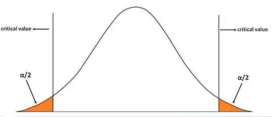

The critical value of a test at the 5% level is a value $t^*$ that cuts 2.5% of the probability from the upper tail of the distribution $T(\nu)$ and 2.5% of the probability from the lower tail. See below for $\alpha = 5% = 0.05$.

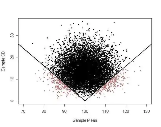

To understand the profound difference between a test using both $\bar X$ and $S$ and a test using only $\bar X$ one can make a bivariate plot or pairs $(\bar X, S)$ from many samples of size five. For these samples $\mu = \mu_0 = 100$ and $\sigma = 15$. In the samples corresponding to light points (5% of them outside the 'envelope flap'), the null hypothesis would be rejected at the 5% level. A test based only on $\bar X$ would have parallel vertical lines as boundaries, ignoring $S$. A t test rejects for the appropriate $combination$ of $\bar X$ far from $\mu_0$ and small $S$.
