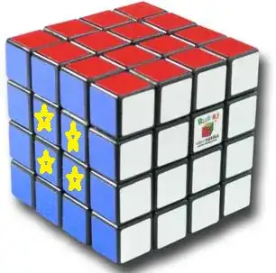

But on the $4\times 4\times 4$ cube, this fails. All $4$ of the starred stickers here, for example, are indistinguishable, in the sense that you could permute them and still have a solved state. I don't think a permutation of just these $4$ stickers is possible, but there are many permutations of indistinguishable cubies which can be done. According to Dustan Levenstein in the comments, any even permutation of these 4 stickers (or more generally of any center stickers) is possible.
The way to prove formally that the $4\times 4\times 4$ cube is not a group is to find a sequence of moves that acts as the identity on one configuration, but not on another configuration. This is pretty easy to do, but I don't remember the precise solution, so I'll omit it. (If anyone really wants such an example, comment and I can dig one up.)
It is true that if we labeled all of the stickers somehow, forming a so-called "supercube", and required that the labels also match up, then we would have a group. This group would be constructed in the same way as the $3\times 3\times 3$ group, as a subgroup of the symmetric group on the $96$ stickers of the $4\times 4\times 4$ cube.
This group acts on the set of positions of the $4\times 4\times 4$ cube transitively, but not freely. This, in group theoretical language, is why the $4\times 4\times 4$ cube positions do not form a group. We can still study the larger group, but we need to take into account that the action isn't as nice as in the $3\times 3\times 3$ case.
