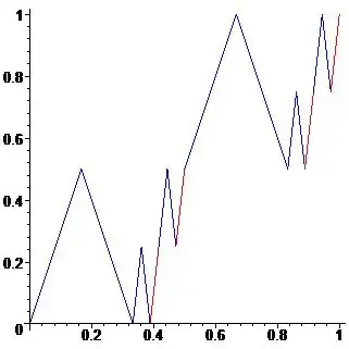

I'll define a convergent sequence of functions $f_n: [0,1] \to [0,1]$, which will be piecewise linear, starting with $f_0(x)=x$. For each $k \in \{0, 1, \ldots, 2^n - 1\}$ a particular segment of the graph of $f_n$, call it $L_k$, will go from $y = k/2^n$ to $y = (k+1)/2^n$. For $f_{n+1}$ we replace each $L_k$ by a "zigzag" with the same starting and ending points, first going from $y=k/2^n$ to $(k+1/2)/2^n$, then back down to $k/2^n$, up to $(k+1/2)/2^n$ and then $(k+1)/2^n$, down to $(k+1/2)/2^n$ and up to $(k+1)/2^n$. The distinguished segments of the graph of $f_{n+1}$ corresponding to the intervals $[k/2^n, (k+1/2)/2^n]$ and $[(k+1/2)/2^n, (k+1)/2^n]$ are the rightmost segments of this zigzag with $y$ in those intervals. For example, here is the graph of $f_2$, with the four distinguished segments in red:
Then $f_n$ converges uniformly to a continuous function $f$ which has the desired properties.

  • I considered this sort of construction too, in a slightly different from: starting with $f(x)=x$, repeatedly (a) bisect each segment in the graph; (b) replace each segment with an N-shaped zigzag. However, I could not easily rule out the possibility that the limit might attain some value uncountably many times. (Then I switched to the Cantor construction in which the function is defined all at once.) –  May 16 '12 at 00:32
  • If you replace each segment by a zigzag, you will indeed get uncountably many points in the inverse image (which will be a perfect set). Here you get only countably many: for each $n$ and each $y \in [0,1]$, $f^{-1}(y)$ is contained in the union of the finite set $f_{n}^{-1}(y)$ and an interval whose length goes to $0$ as $n \to \infty$. – Robert Israel May 16 '12 at 01:36
