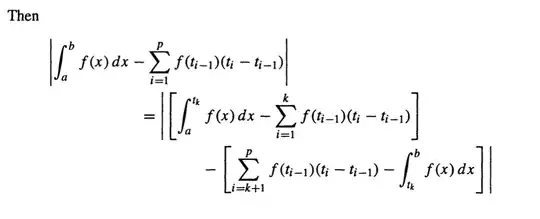

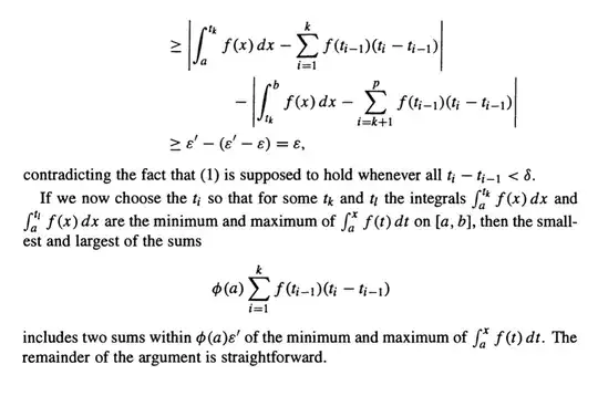

$(\rm c)$ If we set $$a_i=f(x_i)(t_i-t_{i-1})$$ and let $$\begin{align}m&=\text{smallest of the }\sum_{i=1}^k f(x_i)(t_i-t_{i-1})\\M&=\text{largest of the }\sum_{i=1}^k f(x_i)(t_i-t_{i-1})\end{align}$$ then $m\leq a_1+\cdots+a_k\leq M$ for all $k$. Letting $b_k=\phi(x_k)$ in part $\rm(b)$, we find that $$\sum_{i=1} ^n f(x_i)\phi(x_i)(t_i-t_{i-1})$$ lies between the smallest and the largest of the sums $$\phi(x_1)\sum_{i=1}^k f(x_i)(t_i-t_{i-1}).$$ $\,\,\,$ Since we can approximate $\int_a^b f(x_i)\phi(x)\,dx$ by sums $\sum\limits_{i=1}^n f(x_i)\phi(x_i)(t_i-t_{i-1}),$ and $\int_a^x f(t)\,dt$ by sums like $\sum\limits_{i=1}^k f(x_i)(t_i-t_{i-1})$, the final result should follow from the above. However, some care is required for the argument: $\,\,\,$ Given $\varepsilon>0$ we can choose $\delta>0$ so that whenever all $t_i-t_{i-1}<\delta$ we have $$\tag{1}\left|\int_a^b f(x)\,dx-\sum_{i=1}^n f(t_{i-1})(t_i-t_{i-1})\right|<\varepsilon$$ We claim that for any $\varepsilon'>\epsilon$ it also follow that for each $k$ $$\left|\int_a^{t_k}f(x)\,dx-\sum_{i=1}^k f(t_{i-1})(t_i-t_{i-1})\right|<\varepsilon'.$$ The idea is that if we had $$\tag{2}\left|\int_a^{t_k}f(x)\,dx-\sum_{i=1}^k f(t_{i-1})(t_i-t_{i-1})\right|\geq\varepsilon',$$ then by choosing some $p>n$ and new $t_{k+1}<t_{k+2}<\cdots<t_p=b$ we could make the sums on $[t_k,b]$ so close to $\int_{t_k}^b f(x)\, dx$ that inequality $(2)$ would contradict $(1)$. More precisely, choose $t_{k+1},\ldots, t_p$, still with $t_i-t_{i-1}<\delta$, so that $$\tag{3}\left|\int_{t_k}^bf(x)\,dx-\sum_{i=k+1}^p f(t_{i-1})(t_i-t_{i-1})\right|<\varepsilon'-\varepsilon>0.$$

However, this answer depends on the "assumption" I made in the bold sentence above. I've tried to prove this part, but have been unsuccessful. I think I followed the intentions of the written sketch in the last paragraph of the solution, but I can't get this part straight by any means. I would immensely appreciate it if anyone could show me how to solve this part, thanks for reading this long writing.
