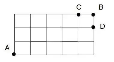

I guess an intuitive way to prove (a) is as follows. Consider an $n\times (p-n)$ grid. Suppose you want to move from the lower left corner $A$ of this grid to the higher right corner $B$, and that you are only allowed to move right (r) or up (u). Therefore, each path from $A$ to $B$ will be a sequence similar to "u,r,u,u,r....", etc. Thus, you have $\frac{p!}{n!(p-n)!}$ ways to go from $A$ to $B$. Now, consider the following example (in which $n=3$ and $p=6$) :
Let's note $N(X,Y)$ the number of paths we have between two points $X$ and $Y$ (still only using r or u movements). From the figure, we see that
$N(A,B)=N(A,C)+N(A,D)=\frac{(p-1)!}{n!(p-1-n)!}+\frac{(p-1)!}{(n-1)!(p-n)!}$
Which is what was asked in (a).
